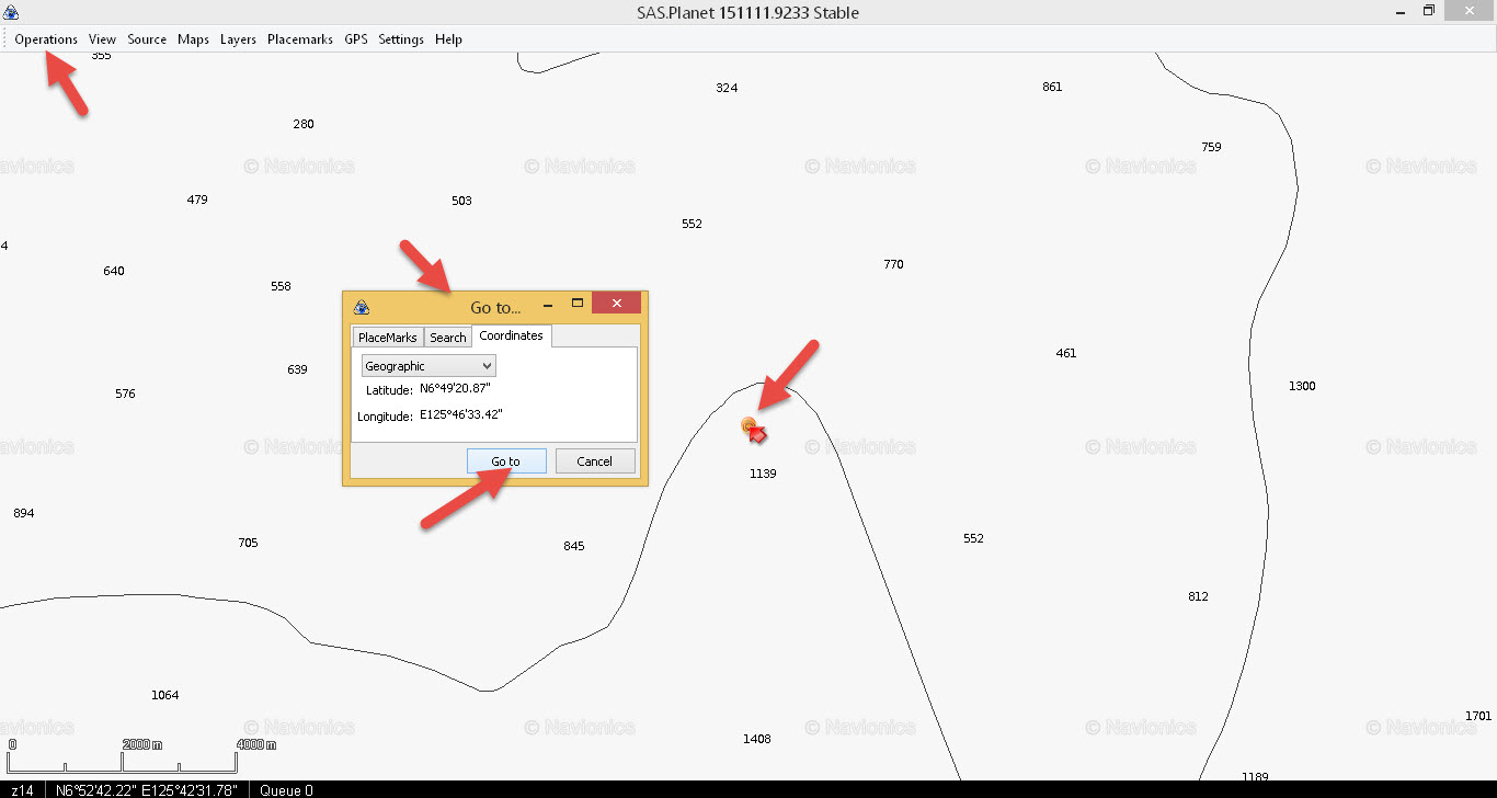

Summary | 0002904: Option not to create mark on Goto | ||||||||||||
Description | When I issue a Goto using lat/lon coordinates it produces a mark with an arrow at that location. I would like to have an option not to produce this mark. | ||||||||||||
Steps To Reproduce | Operations... Goto... enter Coordinates lat/lon .. Press Goto | ||||||||||||
(0016817) Garl (manager) 13-11-2015 17:15 |
use [GotoMarker] ShowTickCount=0 in SASPlanet.ini |

(0016825) phiggins (reporter) 13-11-2015 22:28 |
Tthat does not work. Still get marker when [GotoMarker] ShowTickCount=0 and it resets back to 20000 when SasPlanet restarts. |

(0016828) phiggins (reporter) 14-11-2015 09:55 |
Setting ShowTickCount=0 removes the arrow but it still leaves a circle. Is there anyway to remove the circel or make it more transparent? |
(0016829) Garl (manager) 14-11-2015 16:09 |
phiggins: yes circel is still present, it is show results of search. all: может сделать опционально изменяемыми\отключаемыми крыжики? имхо отказываться совсем от них не стоит ввиду того что они очень наглядны и удобны... |
