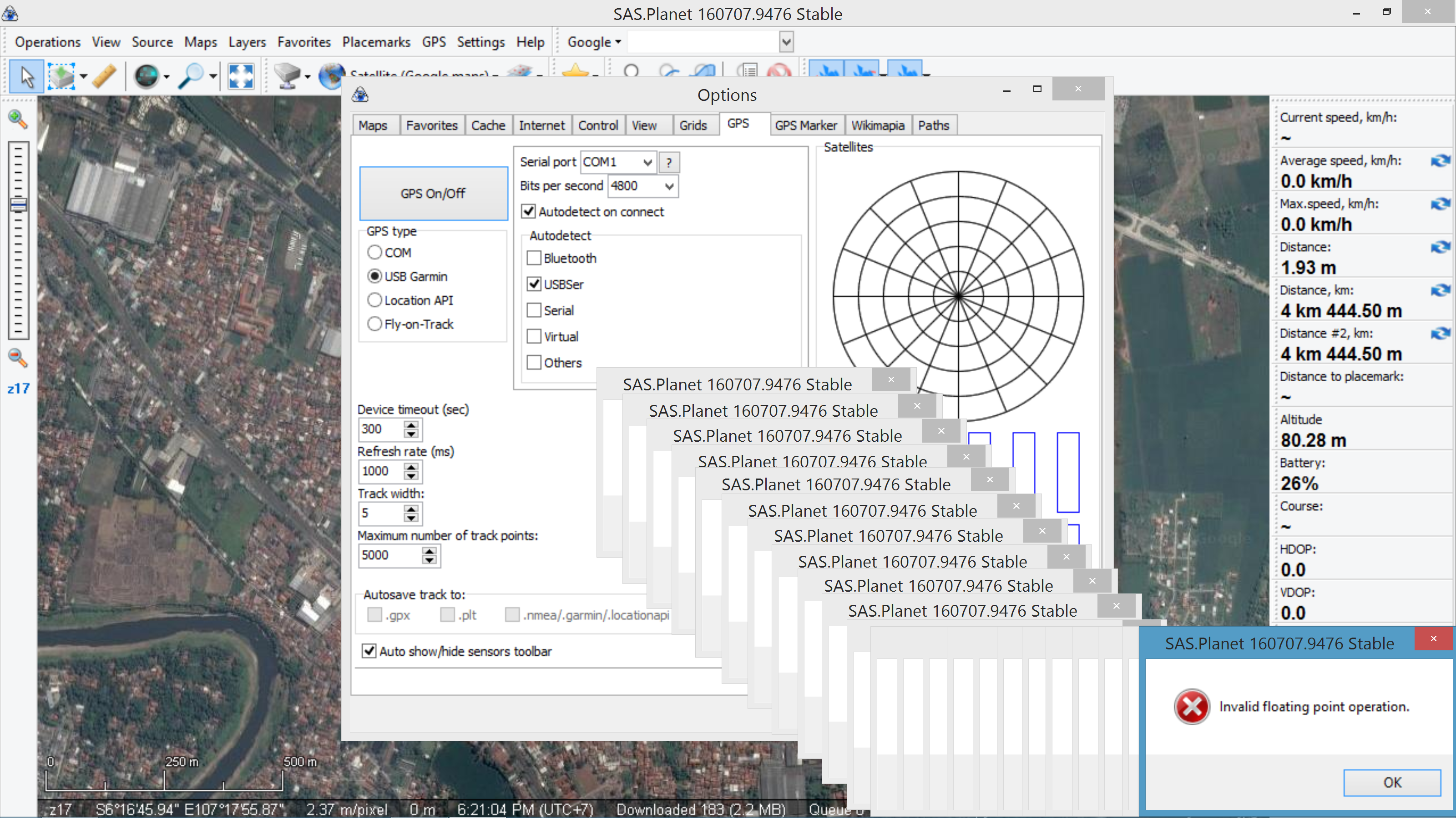

Summary | 0003276: Floating point errors | ||||||||
Description | I think this may have something to do with the GPS? I have a Garmin GPS18x USB. The application is unusable. | ||||||||
Steps To Reproduce | Connect GPS to application. Play around a bit. It sometimes happens almost immediately after connecting, sometimes it takes a little while. | ||||||||
Additional Information | Please see this video. The crash is at the end. https://youtu.be/BcjINKhuG4o | ||||||||

(0018084) dzwager (reporter) 15-10-2017 11:26 |
In the regular SASPlanet app I just updated the google version number to 745. But I am right away again getting the floating point errors. SEE ATTACHED PNG file |

(0018089) zed (manager) 15-10-2017 12:34 |
I don't see error in attached log. Do you reproduce it? Can you take screenshot with error message? |
