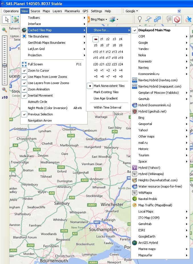

Tab "View"
Toolbars - select Toolbars.
Interface - Select the interface elements are displayed.
Cashed Tiles Map - with the help of the highlighting shows the presence and absence of the program cache tiles that fill the region bounded by the display screen.
For the current map, you can select the scale for which you want to fill the map or cancel.
Show for … - map selection or layer, that creates the map.
Tile Boundaries - outlines of tiles displayed on the screen and their numbers horizontally and vertically.
  • No - cancel the display of the tiles.
  • Current zoom - display the tiles that scale, which is currently on the screen. If you change the zoom, and the boundaries will change.
There is also a direct selection of the zoom, starting with the current (active) and five levels up.
GenShtab Maps Boundaries – outlines of map sheets of the GenShtab (Soviet General Staff) displayed on the screen.
Full Screen - map image over the whole screen, hiding the toolbar. When you move the pointer to the top of the screen toolbar appear automatically. Hotkey F11 supported.
Zoom to cursor - double-click on the map to move the map so that the pointer becomes the center of the screen.
Use Maps from Lower Zooms - in the absence of large zoom Selected basemaps in cache tiles the formation of large zoom tiles will be created from a smaller zoom tiles. The image quality deteriorates!
Use Layers from a Lower Zooms - in the absence of large zoom overlay layers in cache tiles the formation of large zoom tiles will be created from a smaller zoom tiles.
Zoom Animation - visual effects.
Inertial Movement - smooth zooming
Azimuth Circle - display of the compass is in the center of the screen.
Night mode (Color Inversion) - all the colors of the map change on the inverse. It supports hot keys Alt + N.
Previous Selection - screen display outlines of a last selection.
