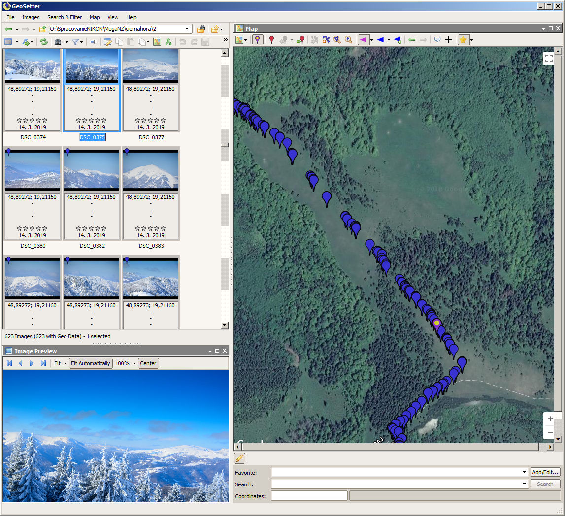

Attached Filesjpg file icon GeotaginGeosetter.jpg [^] (331,065 bytes) 21-03-2018 16:05

GeotaginGeosetter.jpg even in SAS it might look like this
Exiftool is copied to the SAS directory.
use is simple.
for example
exiftool -geotag=track1.gpx "O:\NIKON"
(O:\NIKON directory with photos)
https://sno.phy.queensu.ca/~phil/exiftool/geotag.html
just make an interface where the photos can be deployed
